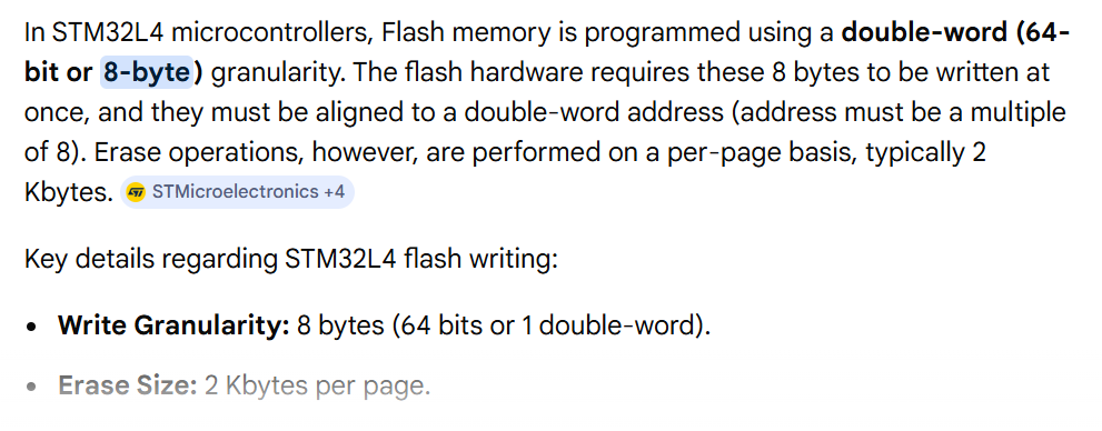

I recall reading in documentation, perhaps rm0432, that the flash is 64 bits wide. I would prefer to do a single write of a float value 32 bits. The only reason I went to 64 bits at a crack was (possibly in error) because of endurance.
I shall work some more at this. Thanks.
2026-03-07 1:29 PM
from google...
