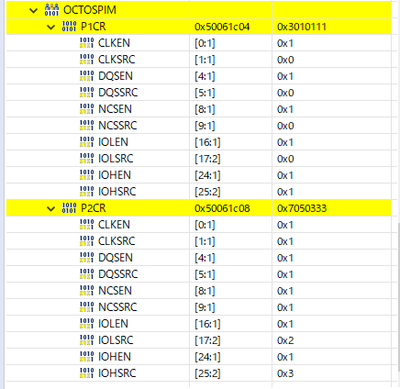

Just in case, I share the register setting values of OCTOSPIM.
