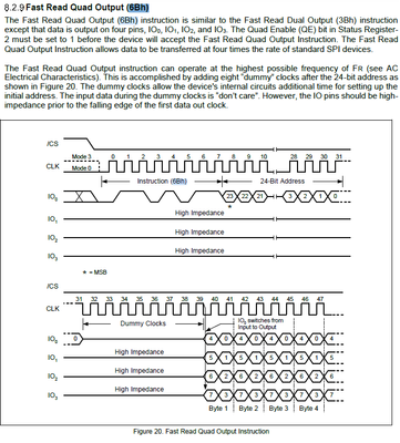

w25q64jv revj 03272018 plus.pdf

When reading, the register is set to use the following commands.
w25q64jv revj 03272018 plus.pdf p31
The register values after calling octospi_open and octospi_memory_mapped will be as listed in the first QA.
