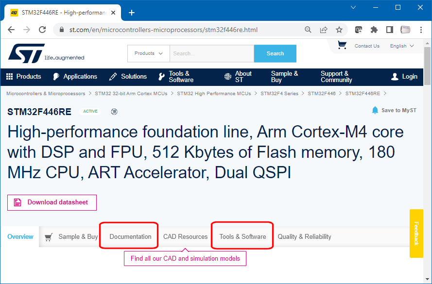

2022-05-19 1:54 AM
First step is always to visit the Product Page and look at the resources available there - that's where you'll find application notes, examples, etc
