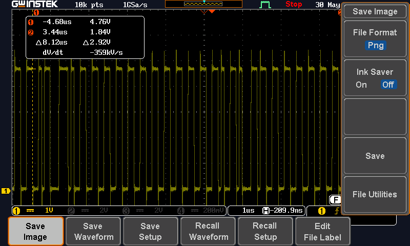

But when the incoming data except the Valid-bit all are 0 (means the device on the other end has 0 at Aux, Data and the flags except "Valid"), the interrupt never happens. The preamble of course is still valid, so that proper frames can be detected:
So shouldn't this also cause an interrupt to occur when there are enough SPDIF-frames detected? Or is there something special needed in order to receive such 0-data-frames too?

From SPDIF-frame's point of view it should be fine, there are valid preambles, the "valid"- and the "parity"-bits are set properly. Just the payload is completely at 0 (including user-, control-bit, data and auxiliary).
