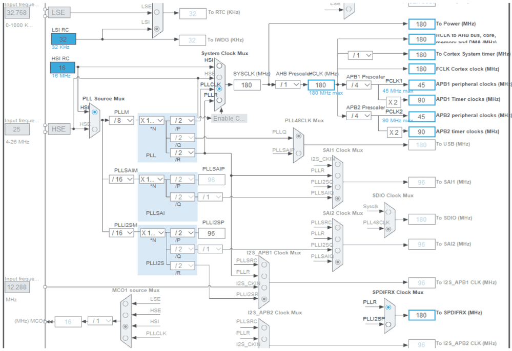

Clock configuration was done in a way where the core (SYSCLK) is at 180 Mhz, SPDIFRX also gets 180 MHz. Hope this is correct as I'm somewhat unsure about this part.

Where I'm still unsure: my clock settings. I just played around with them in STM32CubeMX until I got a core clock of 180 MHz (same clock for the SPDIF subsystem). Can a wrong clock configuration prevent the input from working properly?
