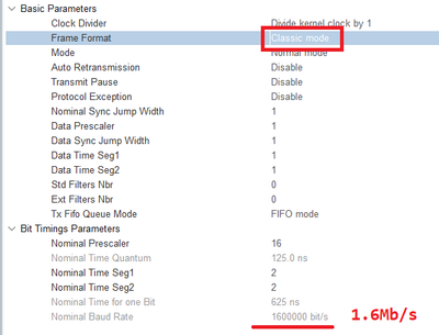

2024-03-14 1:10 AM
Also you are in Classical mode with 1.6Mb/s .. Are you sure this is the config you are using? In classical mode you should not exceed 1Mb/s!
2024-03-14 6:32 PM
I was really hoping this was going to be the problem, but nope. I've tweaked my project file with much more appropriate clocks and CAN timings (we're trying to run at 250 kbps), but it didn't fix anything.
I'm attaching the updated project file and some changed source files (I had also enabled USART3 for some other testing I'll be doing).
