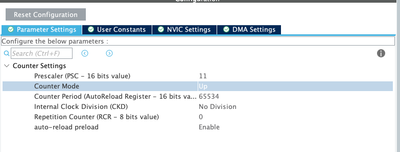

2024-03-14 4:46 AM
htim16.Instance = TIM16;
htim16.Init.Prescaler = 11;
htim16.Init.CounterMode = TIM_COUNTERMODE_UP;
htim16.Init.Period = 65534;
htim16.Init.ClockDivision = TIM_CLOCKDIVISION_DIV1;
htim16.Init.RepetitionCounter = 0;
htim16.Init.AutoReloadPreload = TIM_AUTORELOAD_PRELOAD_ENABLE;And I don't use interrupt for this timer.
Implementing delta for CNT didn't help.

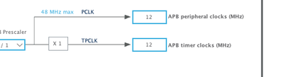

2024-03-14 8:13 AM
Strange but even on 48MHz and release build I got 102uS instead 100us.
2024-03-14 8:44 AM
96 ticks of overhead is consistent with what you saw at 12 MHz clock.
I would guess about half of the overhead is within HAL_GPIO_TogglePin itself.
