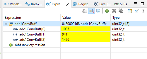

Secure context:
The ADC1 use GPDMA1 CH10 to convert Internal channel VBAT, TEMP_SENSOR and VREF (see watch expression capture below).
PH7 use a Led light on/off to show ADC+GPDMA activity.
adc1ConvBuff[0] = ADC_CHANNEL_VBAT DIV4 ~1034lsb with ADC1 in 12b resolution.
adc1ConvBuff[1] = ADC_CHANNEL_TEMPSENSOR ~941lsb
adc1ConvBuff[2] = ADC_CHANNEL_VREFINT ~1427lsb
Then the secure code start the non-secure code below

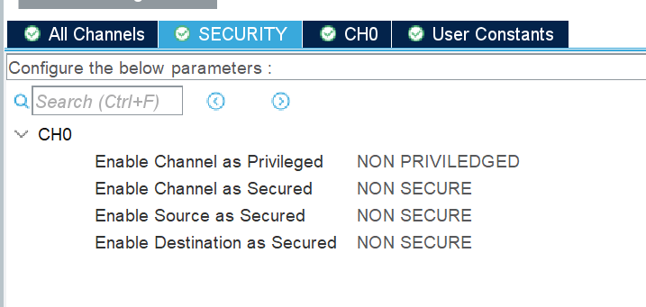

Can you suggest me what changes need to do in above code to run adc in non secure zone?
I follow below configuration steps to run ADC in non secure zone.
1)Take above code as reference.
2)Configure ADC1 in non secure.
3)Configure GPDMA for non secure (Security tab->attached pic).
4)only one time get GPDMA interrupt after that not getting.
Please guide me for same or please provide example code for ADC_GPDMA in non secure.

Change the Runtime context of your ADC1 in the STM32CubeMX configuration from M33S to M33NS.
Then apply same ADC1 and GPDMA1 Parameters setting than my .ioc example, except for GPDMA1 Security, you need to configure a new Channel in Non Secure/Non Priviledged.
Then configure NVIC _NS to generate new GPDMA channel and ADC1 global interrupt.
Check also Security GTZC_S and GTZC_NS, ADC1 should be configured in Non secure mode.
Regards,
romain,
