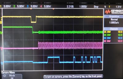

I have an ADC connected to an STM32-L4P5DK. Data should be read in the background by the DMA controller. SPI TX is assigned to DMA1 CHANNEL2, and SPI RX is assigned to DMA1 CHANNEL3. Both DMA1 CHANNEL2 and CHANNEL3 are synchronized with EXTI1 (DRDY signal from the ADC). The STM32 SPI2 is configured as a full-duplex master. Both SPI TX(to transmit dummy bytes) and RX are synchronized with the external interrupt (pin PD1 is assigned to DRDY).
The problem is that I can see the data on the scope, but SPI2 is not receiving any data.

Yellow - DRDY from ADC , Green - CS , Red - SCK , Blue - MISO.

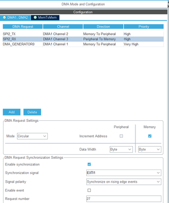

SPI RX config:

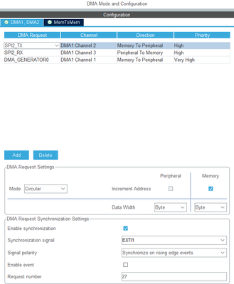

SPI TX config.

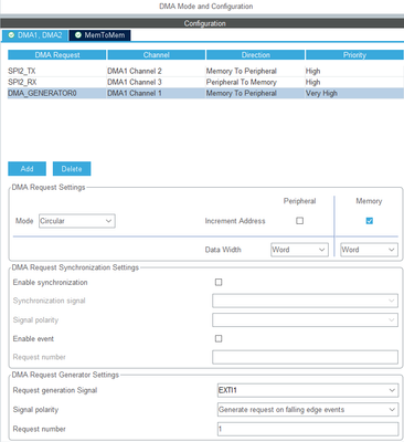

No , I am writing GPIOx_BRR register on every falling edge of DRDY signal to reset the chip select pin (active low). All the DMA requests(SPI_TX , SPI_RX and DMA_GENARATOR0) depend on EXTI1
HAL_DMAEx_EnableMuxRequestGenerator(&hdma_dma_generator0);
HAL_DMA_Start(&hdma_dma_generator0,(uint32_t)&cs_pin,(uint32_t)&(CS_GPIO_Port->BRR),1);
then on rising edge of DRDY signal , I am transmitting dummy bytes on tx line to generate clock pulses. So that ADC data can be received.
DMA request generator config.
I am attempting to read 8000 samples per second from the ADC, resulting in a DRDY frequency of 8kHz. On every falling edge of DRDY, a DMA request is generated to make the chip select line LOW. Then, both SPI TX and SPI RX are synchronized with the rising edge of DRDY.
