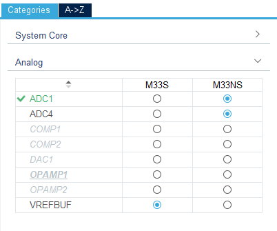

I am using STM32U585ZIT6Q controller in my current project. I am enabled Trust Zone option.
I have configured ADC 1 (4 channel) in non secure with GPDMA.I am not able to read ADC data. I have attached all configuration. I have used HCLK(160MHz) for ADC.
if i got working example then it will more helpful.
Please help me for same.

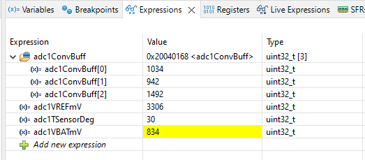

Here attached my previous project with ADC1 in non secure context (NS) and in 12bit resolution.
I also added ADC1 channel computation en mV for VREFINT, VBAT and Degree Celsius for TempSensor.
I do not implemented ADC4, it's up to you for its implementation where you want.

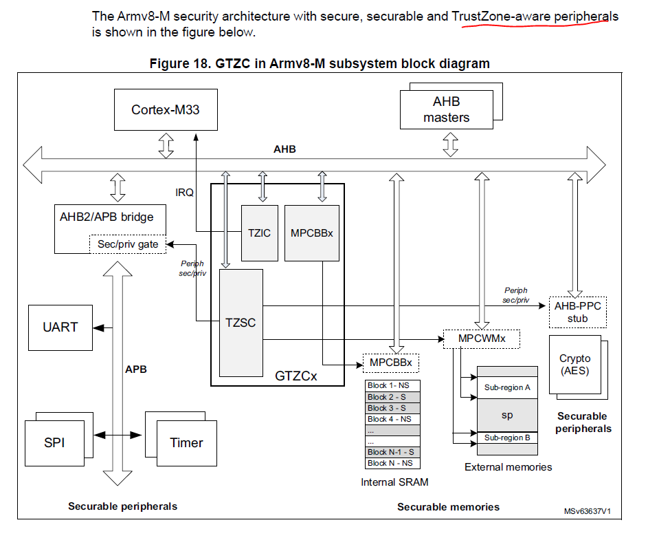

In your case, TZ security is active. so, ADC Peripheral, SRAM memory for GPDMA transfer and GPIO are either securable or TrustZone-aware.
In this case you must use Global TrustZone controller (GTZC) to configure your application in secure mode.
Refer to AN5347 - Rev 6 chapter 4 and 11.
