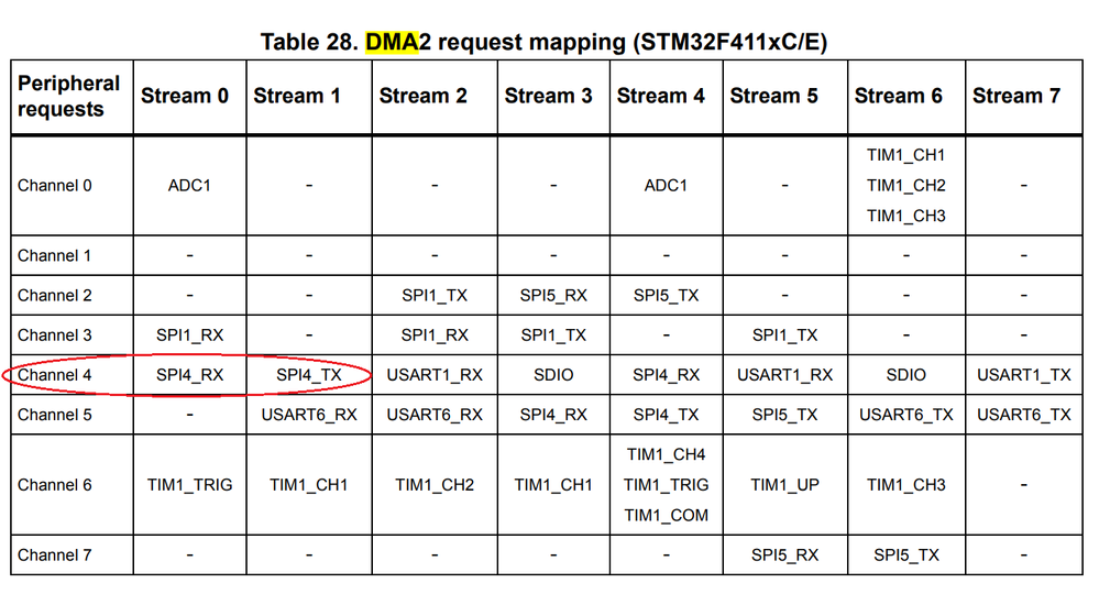

2022-03-01 2:10 AM
Hi @KnarfB ,
Sorry to trouble you again.
I changed SPI1 to SPI4.
I used PA13, 14, and 15 as clock, MISO, MOSI.
The DMA2 stream0 and stream1 as Rx and Tx.
When I run the code, I cannot detect any signals from those 3 pins.
What went wrong?

I read through that link. It seems to me that using SPI4 is not a problem.
I think the problem is PA13, 14, and 15 are not SPI4's default pins. I found SPI4 default pin info in its data sheet: PB13, PA1, PA11.
Can I assign different pins?
