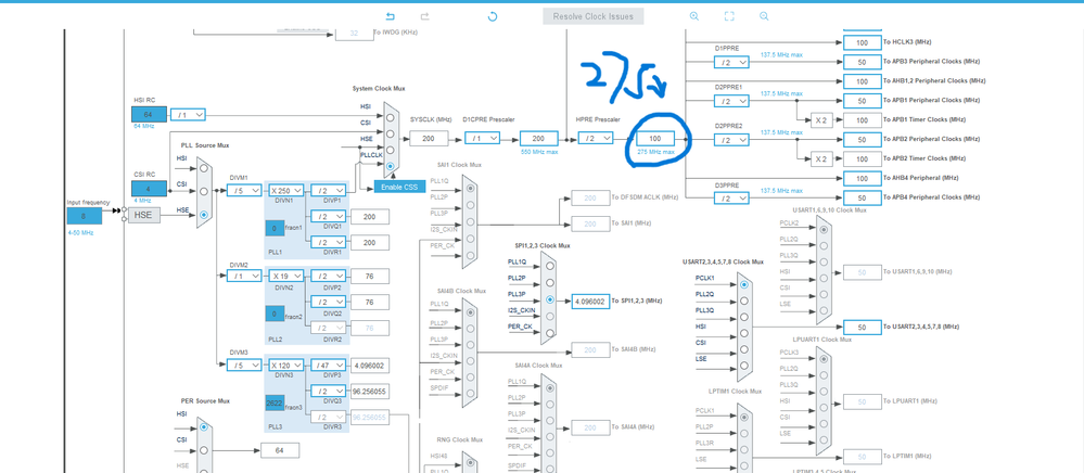

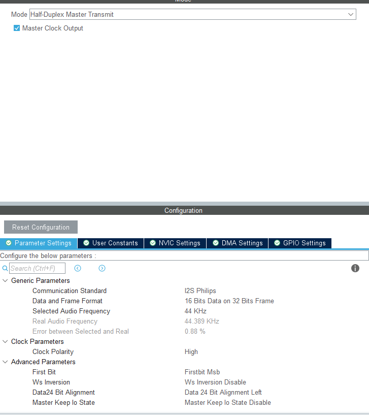

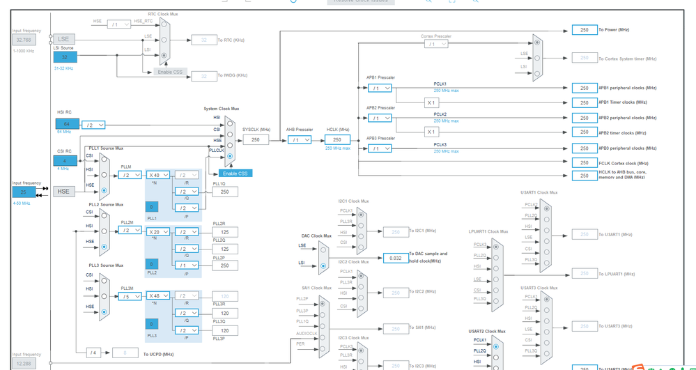

issue i am facing is no clock at i2s2-sck pin.i tries all other i2s port also. i checked clock through logic analyzer .
here is my clock configuration:
i2s configuration:
pins:
i tried other i2s2_sck pins also

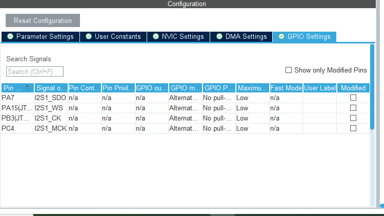

2025-09-09 6:41 AM
yes gpio pin and i2s peripheral are set up correct you can see here:
