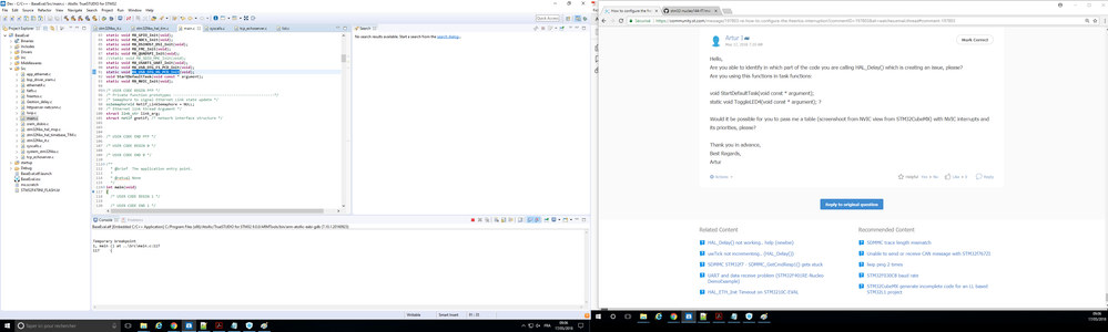

2018-05-16 10:20 PM
Are you able to identify in which part of the code you are calling HAL_Delay() which is creating an issue, please?
Are you using this functions in task functions:
void StartDefaultTask(void const * argument);
static void ToggleLED4(void const * argument); ?

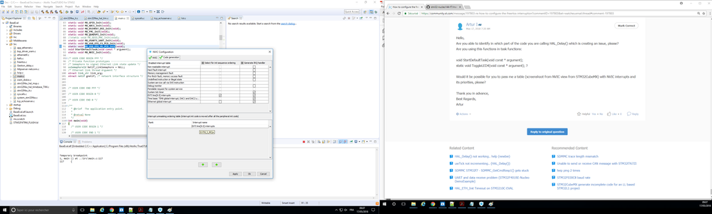

Would it be possible for you to pass me a table (screenshoot from NVIC view from STM32CubeMX) with NVIC interrupts and its priorities, please?

Y ou will find attached the NVIC ocnfiguration from STM32cubMX
Thank you in advance

when I put break point in the HAL_TIM_IRQHandler(&htim6);. It does not go to the timer handler.. I checked the NVIC while debug .. all regiters are set to 0x0 .. I think its problem that tim6 does not launch but i am not sure
what do you think please ?
