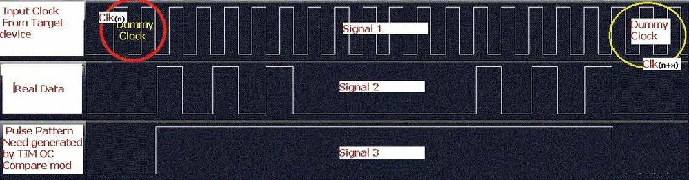

i have a board(a) and this board send some async data with clock to my stm32f4 device.in this data transferred by board(a) have some dummy clock and i want reject this dummy clock.data input clock from board(a) is around 20MHz.

20 MHz is on the high side, might be better addressed with logic than a general purpose timer.
Perhaps you can use the timer in external clock mode, and the output channel in PWM mode, rising edge with CCRx and falling edge with Update. Or perhaps Toggle mode? Or external clock mode driving TIM, driving DMA, to GPIO BSRR2016-11-21 2:54 PM

tnxcould describe more pls?i want use this 20MHz clock as timer clock source.so which timer mode could make a signal like signal3 in picture and how?tnx for your replayWe’re moving the ST Community to a new platform to give you a better and more reliable community experience.
