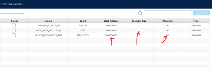

However I cant write data into the memory using external loader. One thing to note that cubeProgrammer is not showing my memory size and my memory type is also appearing as unknown:
This is my structure and its initialisation.

I have tried different boards and also different version of cubeProgrammer (2.17.0 as well as 2.14.0) but this problem is not going away. For some reason cubeProgammer is not able to retrieve the correct information about my page size, my memory type, memory size and also start address.
I am new to external loader world. Any help will be appreciated. Please also see my attached linker filer for your reference:

2024-09-09 3:02 AM
I managed to resolve the problem. Issue was in my structure, i redefined my structure and it resolved the problem.
