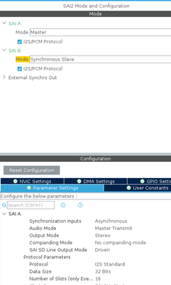

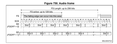

but H563 has 2x SAI :
and each can drive 2 x IS lines, at max. 16 slot (channels) with 32bit , P 2448 :
like this:
