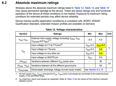

They're mostly in high impedance mode, but the protection diodes are still present.
Look at the "Voltage characteristics" table in the relevant datasheets. Generally an input voltage of 3.3V is fine. More than that can be problematic. Depends on the exact pins you're using.

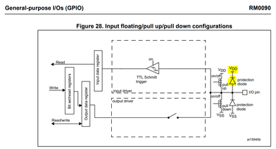

Also look at the GPIO port structure in the reference manual for understanding.

I see in the GPIO schematic that when VDD=0, The MCU will be powered from GPIO pin thru the protection diode (yellow) and this is a big problem.

Not going to argue here, but this statement isn't supported by the datasheet, nor is it supported by posts from ST:

Datasheet is misleading about TT pins:
Input voltage on TT_xx pins | VSS-0.3 | 4.0V
shoid be:
Input voltage on TT_xx pins | VSS-0.3 | Vdd+0.3V
The same time my comments is not correct regarding FT pins, tested on my H743 - no current at 4V w/o Vdd. Seems, it's safe to keep them with external voltage applayed during power off.

I tested now a STM32G030 and a STM32F103 using a multimeter on diode test position.
All GPIO of STM32G030 are FT and I don't find the protection diode from any pin to VDD. Obvious, if this diode were present, will be impossible to input a voltage >VDD+0.6V. The protection diode from input to GND is detected in all pins, but is not important for me.
STM32F103 has FT and TT GPIOs, and the protection diode from GPIO to VDD is present on TT pins.
I have tested on a STM32F103 that I suspect is fake, and the protection diode is present on ALL GPIOs. This don't has any FT pin.
In conclusion, I think that I can use any FT pin. However I will do more tests.
It's certainly possible if the protection diode for FT pins is a 4 V zener, which the evidence strongly suggests.
2023-09-18 9:11 AM - edited 2023-09-18 1:30 PM
Yes, it looks like a zener diode in series with a rectifier diode to avoid the forward polarization current of the zener diode.
