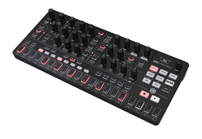

2023-09-16 3:41 PM
ok, funny...
but wtf you build analog synth ? just for fun ? (hobby, this i could understand :) )
can have analog synth for 500$...
https://www.thomann.de/de/ik_multimedia_uno_synth_pro_x.htm
how many hours you need, to build something like this ? 500 ?
i made my first (and only) digital sampling synth 35 y ago, but Yamaha and Korg been faster... no surprise, they have not only one guy building this.
so tell me, why and for what use ?
+ PCM1681 seem good bang...but can use any cpu, you need no real fast core, so (think about, what you can get on market now really) "old" F103 should be fast enough, but for 8ch I2S you need a chip with SAI interface, G431 has it, but i would recommend a new series, i have H563 disco here, 2x SAI , 144 pins... 30$ for ready board, to make experiments.
