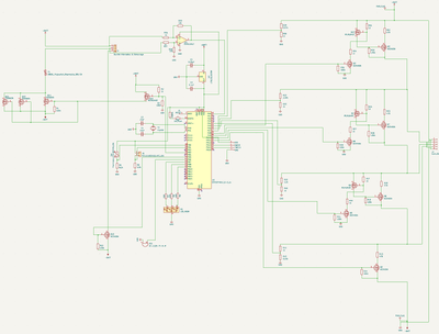

Can i show you my schematic and give me back some tips or some mistakes that you can find for improve and upgrade my card ?
2024-04-29 7:00 AM - edited 2024-04-29 7:00 AM
That image is too low resolution to read.
Do you have a PDF, or a high-resolution image?
A description of what it's supposed to do would also help.

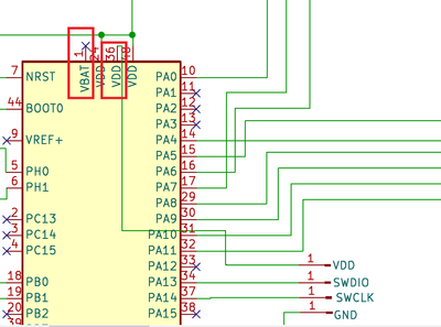

I thought it wasn't necessary to connect Vbat because I don't use it, and for VDD, i thought that all VDD were connected together inside of the MCU.
You need to connect VBAT to VDD if the backup domain is not used. From RM0368 rev 5 / page 72:
You need to connect all the VDD pins to 3.3V. That's why from the beginning I suggested you to refer to the documentations and especially the AN4488.
2024-04-30 12:50 AM
Yes but I use a battery so i thought it wasn't necessary. Yes for the next version of my card will use the AN4488 document before.
2024-04-30 1:19 AM

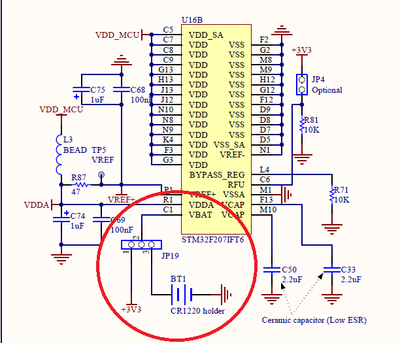

You need to put a jumper of switch on VBAT pin to to select between Battery source or VDD.
This is an example from STM3240G-EVAL board:

Ok I will do this for the future card, so do you think that for my current card, i can't correct problems inside ?
2024-04-30 6:13 AM
I think it's probably best to start again - after thoroughly studying the datasheet, reference manual, application notes (including, but not limited to AN4488), and the dev board schematics.
