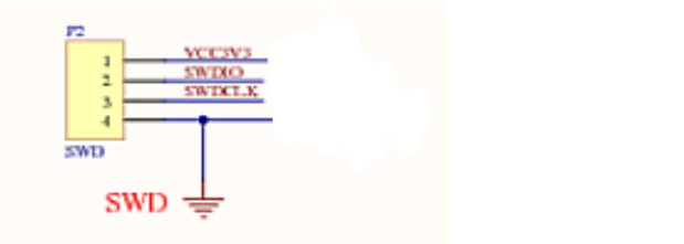

For my HW, I have this, is it correct ?
2024-04-29 6:10 AM
That's a very poor image - hard to read what the text says.
And it tells us nothing, as it doesn't show where those lines actually go!
It's best to include NRST on the programming/debug header - this can get you out of some "stuck" situations...

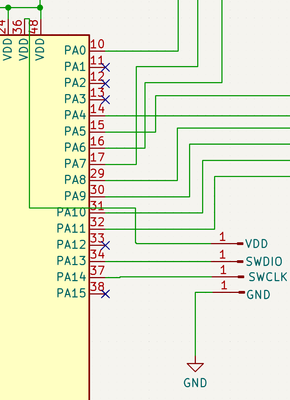

Sorry i'm fresh and new developer ! This is my schematic. These pin are connected to Pin header, in my PCB.
2024-04-29 6:22 AM - edited 2024-04-29 6:25 AM
What's going on here?
It looks like you've only connected pin 36 of the STM32 to pin 1 of the programming connector?
All of your VDD pins need to be connected together!
Again, as @mƎALLEm has repeated a couple of times, you really need to study the AN4488 Application Note!
You should also look at the ST Dev Board schematics as examples ...

Sorry but i never hered something about the AN4488 and here a I see that it stuck me in my developement. I have to connect all VDD together but i also have toconnect all my GND together or not ?
2024-04-29 6:33 AM
@yassir wrote:Sorry but i never hered something about the AN4488
The first thing when starting using a new chip should be to spend time studying the available documentation.
ST (like most other manufacturers) helpfully gather this all together into one place - called the "Product Page":
https://www.st.com/en/microcontrollers-microprocessors/stm32f401cd.html
There you'll find the datasheet and all other supporting resources - including the Application Notes.
@yassir wrote:i also have to connect all my GND together or not ?
Yes.
