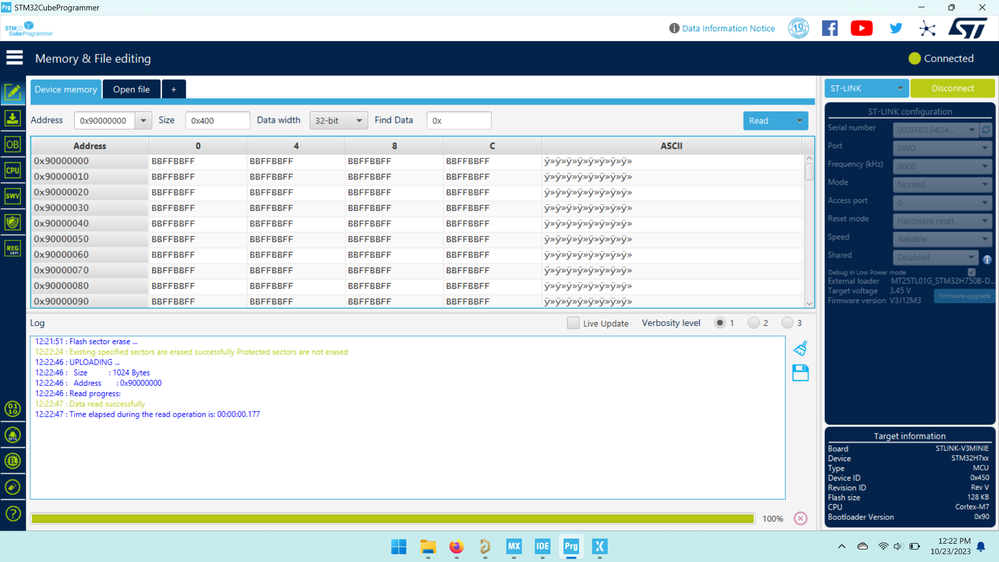

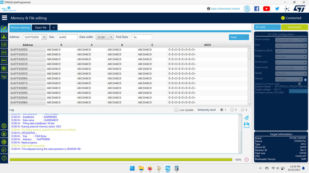

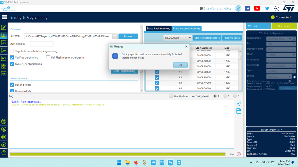

I have tried with different values and it seems to be working fine , But I tried to mass erase the NOR FLash and Got this I again wrote in the last memory address 0x97FE0000 and the data seems to be written perfectly fine as shown
2023-10-22 7:20 PM
oh, it seems mass erase not fully functional. But as I remember, the more important is, to program code or data, the flow is erase block(s) + program block(s), random data files may be used to test if such operation is fully functional.
2023-10-22 11:54 PM
As shown in the pictures I can confirm that the data is not erased from the NOR Flash it can Only Be re written
