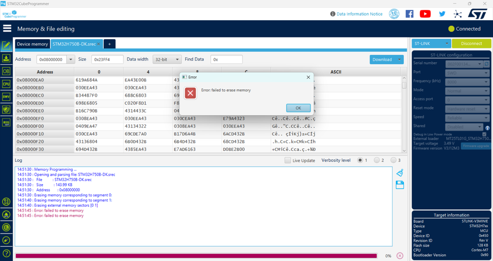

Ok Thanks for the input, I have set the output to .srec and tried to program as specified by you and got the following results
2023-10-19 2:58 AM
Your previous operation at 2nd tab was OK to erase NOR flash, you may try in that way.

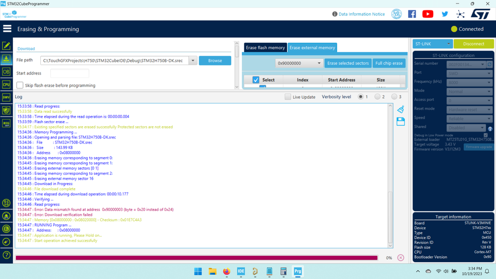

2023-10-19 7:35 PM
oh, almost the same status as the first post.
Well, you may try the following to avoid side effect:
1) erase internal flash
2) power down and re-power the board
3) do the programming again (I mean, previous operation at 2nd tab)
There is strange point for me: "Board : STLINK-V3MINIE". I suppose the board name information should be "Board : STM32H750B-DK".
