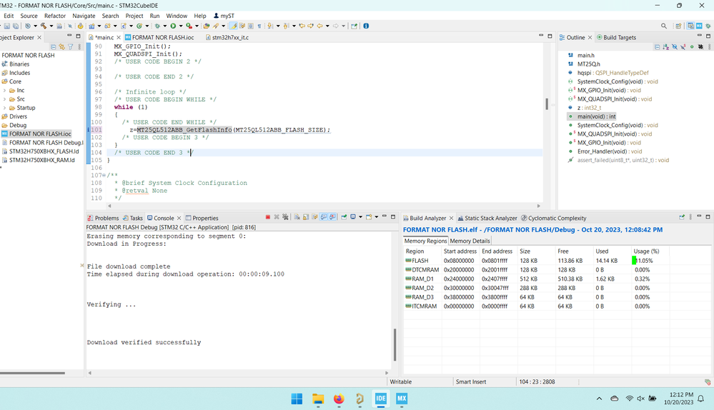

2023-10-18 12:04 AM
ST-LINK SN : 002F00134D46501420383832
ST-LINK FW : V3J12M3
Board : STLINK-V3MINIE
Voltage : 3.43V
SWD freq : 8000 KHz
Connect mode: Under Reset
Reset mode : Hardware reset
Device ID : 0x450
Revision ID : Rev V
Device name : STM32H7xx
Flash size : 128 KBytes
Device type : MCU
Device CPU : Cortex-M7
BL Version : 0x90
Memory Programming ...
Opening and parsing file: ST-LINK_GDB_server_a05624.srec
File : ST-LINK_GDB_server_a05624.srec
Address : 0x08000000
Erasing memory corresponding to segment 0:
Erasing memory corresponding to segment 1:
Erasing external memory sectors [0 1]
Erasing memory corresponding to segment 2:
Erasing external memory sector 16
Download in Progress:
File download complete
Time elapsed during download operation: 00:00:10.115
Verifying ...
Error: Data mismatch found at address 0x90000003 (byte = 0x20 instead of 0x24)
Error: Download verification failed
Encountered Error when opening C:\ST\STM32CubeIDE_1.13.2\STM32CubeIDE\plugins\com.st.stm32cube.ide.mcu.externaltools.cubeprogrammer.win32_2.1.0.202305091550\tools\bin\STM32_Programmer_CLI.exe
Error in STM32CubeProgrammer
Shutting down...
Exit.

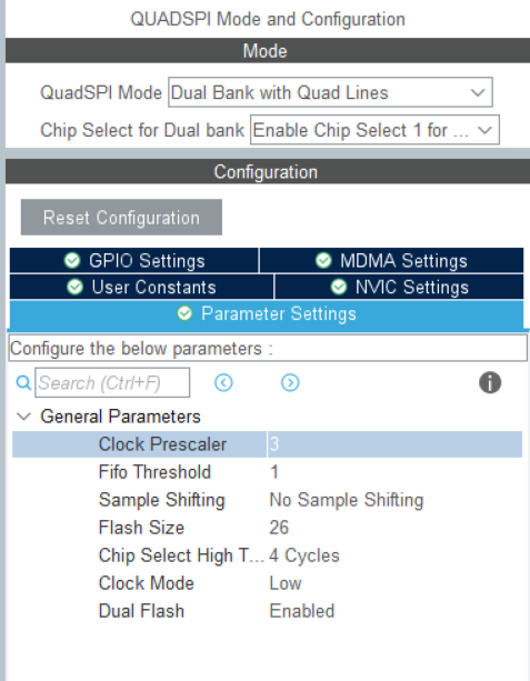

2023-10-19 11:45 PM
I made a bare-bone setup using https://github.com/STMicroelectronics/stm32-mt25ql512abb and setting QSPI Flash as specified in the touchgfx
I am trying to get the Flash Data but the debugger is going into hard_fault interrupt
void HardFault_Handler(void)
/* USER CODE BEGIN HardFault_IRQn 0 */

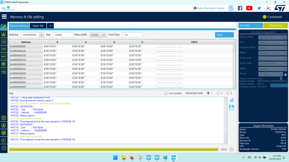

2023-10-20 2:29 AM
I was able to write to External Flash using STM32CUBE Programmer as shown

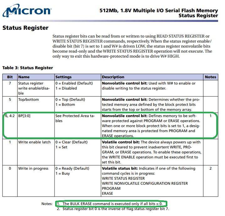

2023-10-20 11:15 AM
>>Could You please specify how to remove block protection?
You'd read the Status Register in the Micron device(s), clear the BP bits, and then write them back. In this dual configuration the Status Register would be a pair of bytes, and the bits in each.
2023-10-20 11:18 AM
2023-10-20 9:53 PM - edited 2023-10-20 9:54 PM
this shows the nor flash not protected (8387 readout)? You may double check by writing different content and resetting the board.
2023-10-20 10:00 PM
I have double checked that I am available to write data on the external flash, starting address is 0x900000 and what is the ending address for flash so I can write the full flash check .
