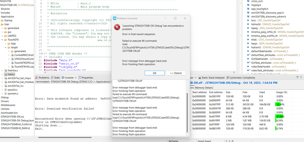

2023-10-18 12:04 AM
ST-LINK SN : 002F00134D46501420383832
ST-LINK FW : V3J12M3
Board : STLINK-V3MINIE
Voltage : 3.43V
SWD freq : 8000 KHz
Connect mode: Under Reset
Reset mode : Hardware reset
Device ID : 0x450
Revision ID : Rev V
Device name : STM32H7xx
Flash size : 128 KBytes
Device type : MCU
Device CPU : Cortex-M7
BL Version : 0x90
Memory Programming ...
Opening and parsing file: ST-LINK_GDB_server_a05624.srec
File : ST-LINK_GDB_server_a05624.srec
Address : 0x08000000
Erasing memory corresponding to segment 0:
Erasing memory corresponding to segment 1:
Erasing external memory sectors [0 1]
Erasing memory corresponding to segment 2:
Erasing external memory sector 16
Download in Progress:
File download complete
Time elapsed during download operation: 00:00:10.115
Verifying ...
Error: Data mismatch found at address 0x90000003 (byte = 0x20 instead of 0x24)
Error: Download verification failed
Encountered Error when opening C:\ST\STM32CubeIDE_1.13.2\STM32CubeIDE\plugins\com.st.stm32cube.ide.mcu.externaltools.cubeprogrammer.win32_2.1.0.202305091550\tools\bin\STM32_Programmer_CLI.exe
Error in STM32CubeProgrammer
Shutting down...
Exit.

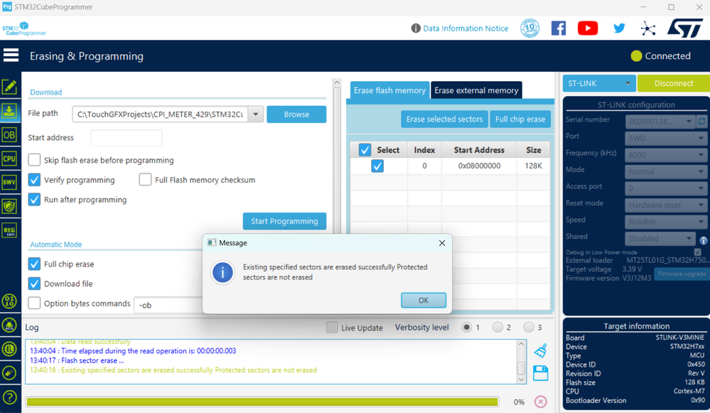

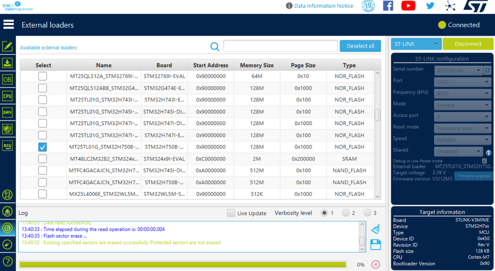

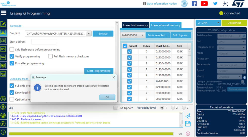

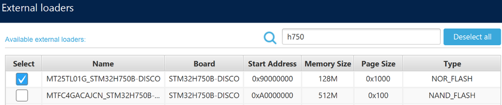

OK, be sure to enable the correct external loader: MT25TL01G_STM32H750B-DISCO for STM32CubeProgrammer to do the programming.
2023-10-19 1:18 AM
I have selected the Loader according to your specifications as shown
Now I format the Internal And External Memories accordingly as shown without any errors
Now i program the STM32H750B-DK With STM32CUBEIDE and get this message

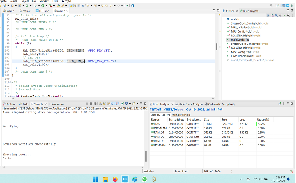

2023-10-19 1:27 AM
You may try:
1) generate .hex file with STM32CUBEIDE
2) program the .hex file with STM32CubeProgrammer. You may get feedback if program is OK or not.
3) if step 2) OK, you may see if the .hex works as you expected
the purpose is to ensure your STM32H750B-DISCO is OK from hardware point of view.
2023-10-19 1:45 AM - edited 2023-10-19 1:47 AM
I followed your steps and The System seems to be working perfectly fine.
I made a simple Blinky Project and it worked as expected.

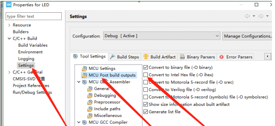

2023-10-19 2:16 AM
You may change setting to generate .hex file:
