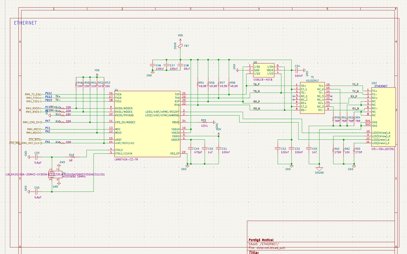

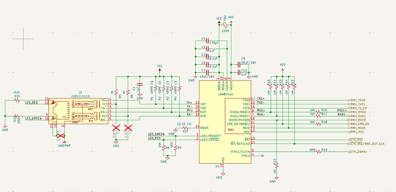

I'm working on a project involving FreeRTOS, lwip, and Ethernet with the ST32H563VGT6 MCU on a custom PCB.
I'm attaching the hardware schematics, which we've taken from ST's schematics of the NUCLEO-H563ZI board. I'm including a PDF with the schematics distributed by ST.
The schematics of my board are shown below:

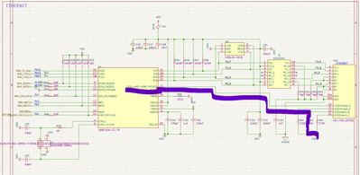

In previous versions of the custom board, we used a different hardware design:
We decided to switch to ST's schematics for greater robustness. The first configuration we tried, shown in the second image, is characterized by the lan8742 clock coming from the MCU's output clock (MC0), and the RJ45 connector comes with built-in magnets. Additionally, it does not include the USBLC6-4SC6 integrated circuit for ESD protection.
The second configuration, corresponding to the first image, uses ST's schematics, which we imported identically to the ST version of the NUCLEO-H563ZI.

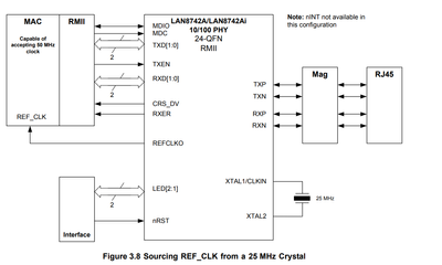

Missing clock into STM32 (RMII_REF_CLK). The difference is in the strap on pin 2 (in its nINTSEL function, read LAN8742 datasheet).
I don't know (and am not interested to find out) how NUCLEO-H563ZI copes with it exactly - if you can get SMI (MDIO/MCLK) working, you can set LAN8742's REFCLKO to output the required clock through that interface.

Upon reset, the PHY sets pullups on certain pins and reads in their state, which is then stored in certain register bits and influence, how PHY works. In other words, the PHY is pin-programmable, to a certain extent, but to spare pins, the programming pins are not dedicated, but they are scanned at reset, and subsequently used for other purposes. This is result of years of PHY development and reduction of number of pins to absolute minimum. External pulldown resistors, used to override the internal pullups, are traditionally called "straps" (from the analogy with piece of leather at the rear top of the traditional leather boot, used to grab on when pulling on the boot).
In particular, the default function of REFCLKO/nINT pin is nINT; but this can be overridden by a strap (pulldown) on nINTSEL pin (pin 2), which ensures that the level on that pin during and shortly after reset is 0. This is latched at reset to an internal latch (in some other PHYs, this internal latch is exposed through registers, in LAN8742 it appears that there's no such register bit, so the only way to enable the reference clock output is through this strap). That clock is then used as input to your STM32 as the RMII reference clock; without that clock the softreset "hangs" (does not auto-clear) as you've described.

However, if you look the schematics, you will see that there is already a pull down resistor on pin 2 (LED2/nINT/nINTSEL).
therefore, the reset should be performed correctly, right?
Should i change the value of the strap?

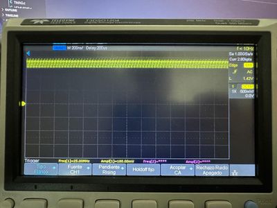

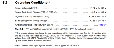

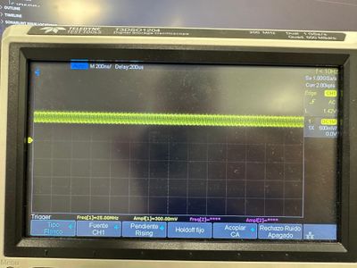

We've encountered an issue regarding the absence of a 50 MHz clock output on the RMII_CLK_REF. Instead, we're measuring a voltage range of 1.9 to 2.1 V at the VDDCR pin, whereas it should ideally be 1.2 V according to the datasheet. In our previous design and on the NUCLEO BOARD, the output reads 1.2 V as specified. As evident from our pictures, we're utilizing the internal Voltage Regulator (with REGOFF internally pulled down). This deviation from the expected VDDCR output voltage seems to be the root cause of our design issue. Although the crystal oscillator is functioning correctly, it appears to have a greater DC offset compared to the Nucleo Board. Comparison of LAN8742 crystal output:

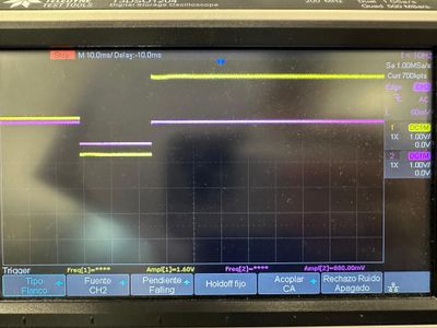

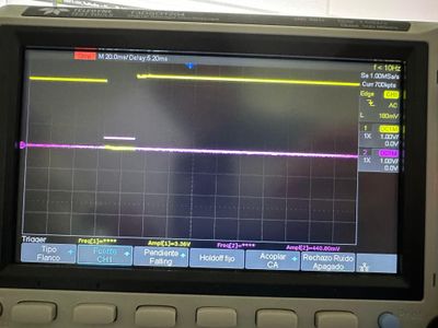

Furthermore, we've observed that the nINTSEL pin is not performing as expected. During a reset period, the behavior differs between the NUCLEO and our second design. On the NUCLEO, the GPIO pin transitions from high to low for 25 ms before going back to high to initiate the reset. Conversely, on our design, the nINTSEL pin exhibits inconsistent behavior, with the GPIO pin initially at 1.2V before initialization, and the output of the nINTSEL pin deviating from its expected behavior.
Comparison of LAN8742 nINTSEL output:
