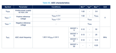

The convertible input range for the ADC is (0, VREF+) which is typically (0, VDD). It sounds like your board has VREF+ = 3.3V.

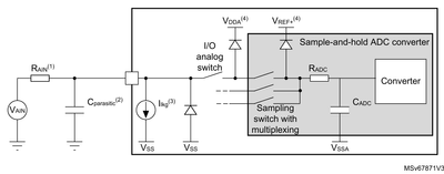

The ADC doesn't have a resistor to ground. You can't use it as one half of a resistor divider. It has some effective series resistances and capacitances.
See here for the effective circuit:
You can do what you're doing, but you will need to use external resistors and have the voltage of the net change based upon what button is being pressed.
