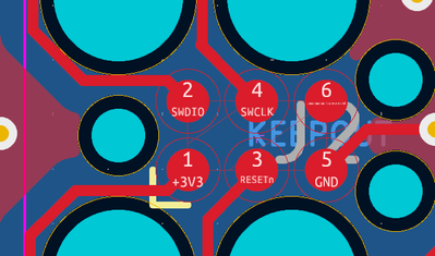

I believe that none of these options is suitable (I would love it if someone can persuade me I'm wrong, of course). The promising ones are the V2-1 and V3E ST-LINKs, but in order to use these I would need either i) to expose the SWO pin of the C091KCT6, or ii) connect PA2 & PA3 on the C091KCT6 to the ST-LINK/V2-1 or ST-LINK/V3E.
Option i) doesn't work because, I think, there is no SWO pin on the C091KCT6.
Option ii) doesn't work because, I think, there is no provision for connecting UART pins to the ST-LINKs ON THE BOARDS from a custom board, only from the MCU on the dev kit board.
If I get the STLINKV3-SET, then I can either connect PA2 & PA3 of the C091KCT6 to it (and do my SPI stuff elsewhere on the chip) or replace the C091KCT6 with a chip that has a SWO pin. (I am not concerned about BoM cost, this is a low volume project. But I am concerned about the cost of buying a J-link :) ).

Wow! that's an overkill. 10 pins is enough. Tag-connect cables are expensive and more pins/holes mean more wasted space on the board. Even 6 pins is enough if you need only the TX line of the UART. If you want the printf to UART be independent from the debugger.
As @Tesla DeLorean wrote, SWDIO and SWCLK pins of STM32C031 can be re-purposed as UART TX and RX. In this case the existing 6-pin connector can be left as is, just the cable should be re-wired to a FTDI or other TTL to USB adapter, or to UART pins of the same ST-LINK v3 MINIE. Indeed a lot of options to consider.

By the by, NRST is already connected to the J-LINK V2 - I placed a 6 pin Tag Connect 'receptacle' on my board with NRST, so I already have that available.
So, for now, I plan to solder wires onto the C091 to bring out a USART to an FTDI232 board I already have. I'll then redesign the board slightly to bring out USART1 to a 14 pin Tag Connect plug of nails and connect that to a new J-Link 3.
