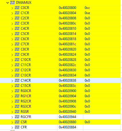

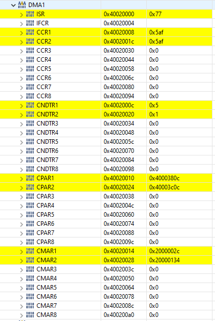

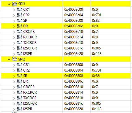

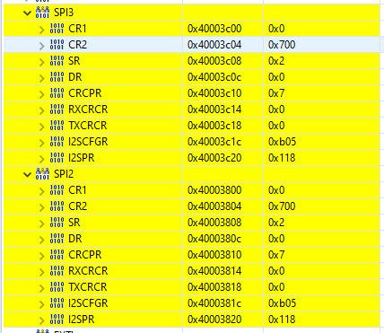

2020-11-18 1:45 AM

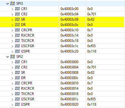

I don't get much out of observing these registers except for that the SPI2 DR register is never changing from 0, the SPI used by the I2S with a problem.
I start the I2S reception with
HAL_I2S_Receive_DMA(&hi2s2, rxBuf1, 4);
HAL_I2S_Receive_DMA(&hi2s3, rxBuf2, 4);Have a go at what you think is the problem - here are some screenshots:

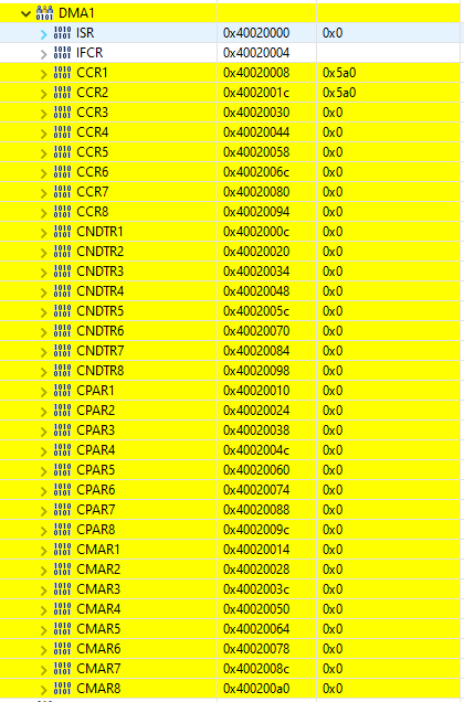

After MX_I2S*_inits:
SPIs
DMAMUX
DMA1

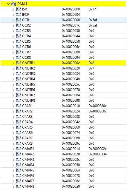

After first RxHalfCpltCallback:
SPIs
DMA1 (DMAMUX is unchanged)

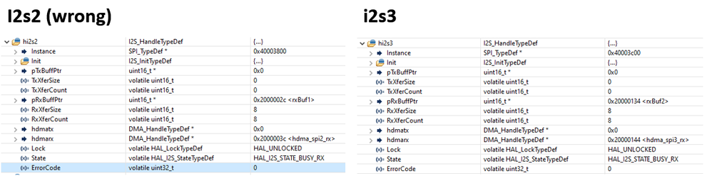

hist data structures

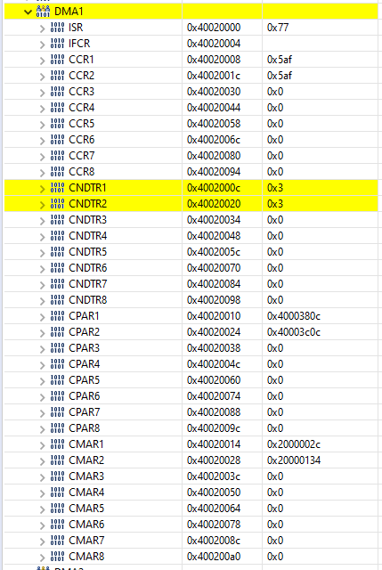

Later RxHalfCpltCallback:
In RxCpltCallback:

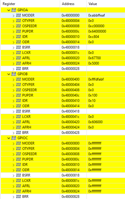

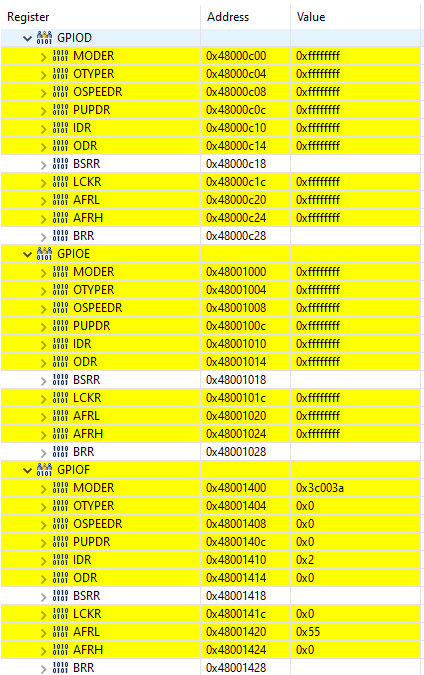

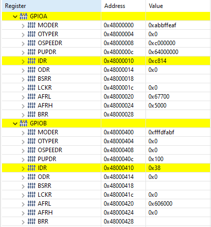

You haven't shown us the respective GPIO registers' content. DR being stuck at 0 - while everything otherwise indicates I2S and DMA running OK - sounds much like data pin for the given I2S not being set in GPIO.
As for interrupts appear to be missing, try a much slower I2S clock, that could perhaps reveal if it's the bloated Cube code or something else.
2020-11-19 12:34 AM
Thank you for your insight!
Here are the GPIO registers just after the I2S init:
In the first RxCpltCallback only these registers changes:
In successive callbacks only the IDR registers of GPIOA, GPIOB and GPIOF changes. Crossing fingers that there is a simple fix.
