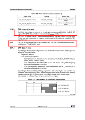

It's apparently consequence of incorrectly handled/misunderstood remark from the RM:
The delay according to 'G431 DS is:
but, as the highlighted remark above indicates, this delay is only in the analog part, nothing prevents the digital part to work normally.
So, to generate a quasi-continuous waveform, it's not just matter of removing the delay, but you should also avoid switching the DMA [EDIT see post below] DAC [/EDIT] off and on.
But, at the end of the day, this is just another case to repeat my mantra: Cube/HAL - as inevitably any "library" - implements only a miniscule fraction of what the hardware is capable of, the arguable "usual cases". And Cube/HAL specifically is primarily a vehicle to allow clicky configuration in CubeMX. If your use case is outside of these "usual cases", Cube/HAL gets into way more than helps. This is not fault of Cube/HAL; it is what it is and using it you agreed to accept its shortcomings.
If you mean developing with STM32 seriously, you are better off using registers directly (no, not Cube/LL, that's mostly just renaming registers thus another unnecessary obstacle). DAC is trivial, timers are relatively easy, DMA/DMAMUX is maybe a bit more involved but in the long run the investment in learning pays off.

@waclawek.jan
Thank you for pointing right way DACxRDY in DAC_SR register for implementing delay instead of insane 1 SysTick :grinning_face:
2023-08-17 8:49 AM
Sorry, my bad, I meant, you should not switch *DAC* off/on (i.e. you should remove __HAL_DAC_ENABLE() / __HAL_DAC_DISABLE() from the functions you are using to start/stop DMA). I've corrected above.
Btw. I went through the Cubes and I found the delay only in 'G4 and 'U5 HAL, whereas the analog part setting (tWAKEUP) is - logically - present and of similar duration in other STM32 families which have DAC, too.
