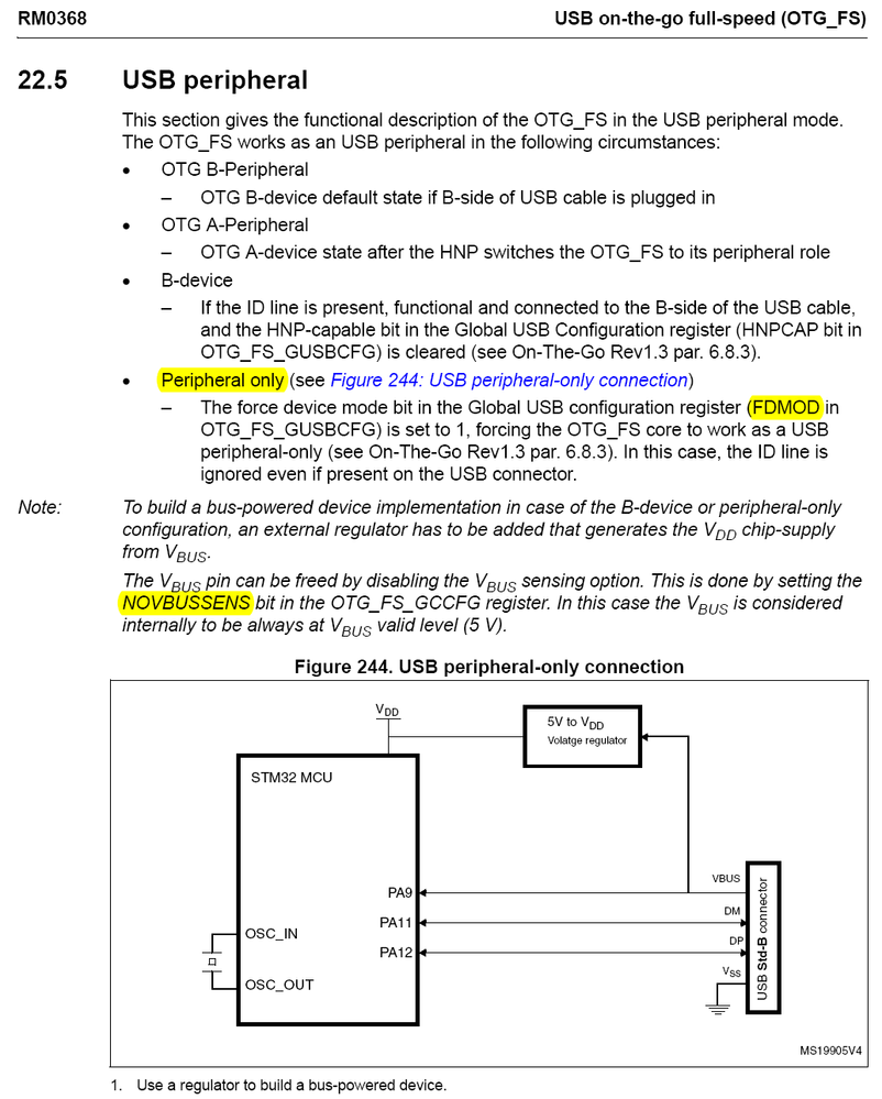

brent239955_st
Associate II
Posted on August 10, 2016 at 16:10
From ''
http://www.st.com/content/ccc/resource/technical/document/reference_manual/5d/b1/ef/b2/a1/66/40/80/DM000968pdf/files/DM000968pdf/jcr:content/translations/en.DM000968pdf
'' , page 669:
The VBUS pin can be freed by disabling the VBUS sensing option. This is done by setting the
NOVBUSSENS bit in the OTG_FS_GCCFG register. In this case the VBUS is considered
internally to be always at VBUS valid level (5 V).
