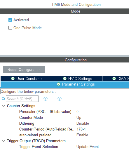

The signal is sampled with the TIMER6 trigger, which is rised every 1us. (MCU clock is 170MHz, TIMER6 PSC is 0 and ARR is 170-1).
TIMER6 configuration

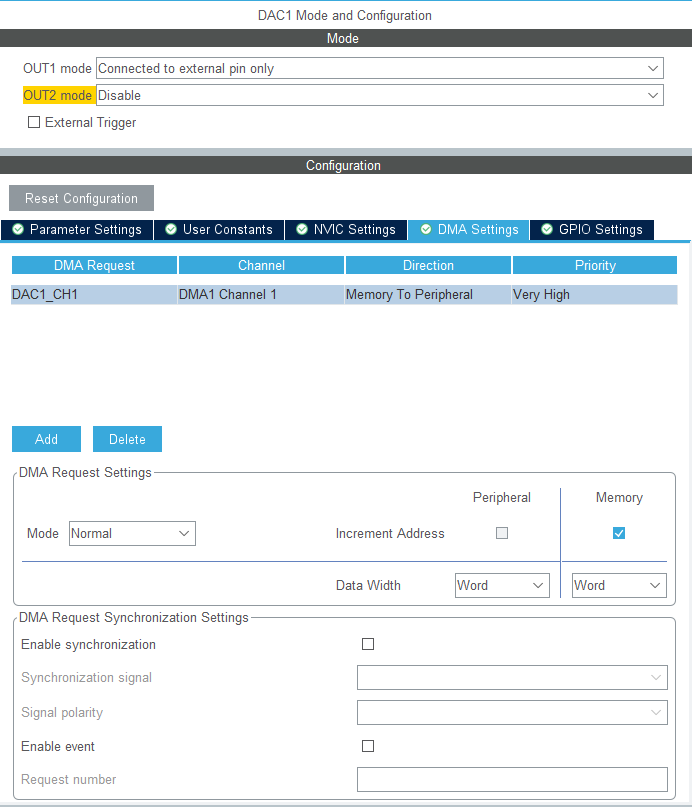

The DMA is set to normal mode (because I want to generate a signal only when the trigger comes, and not continuously)
DAC DMA configuration

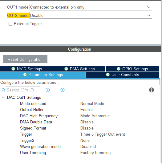

The DAC is configured like this:
DAC configuration

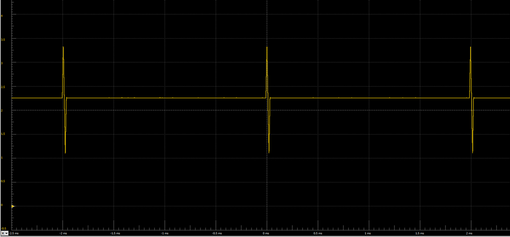

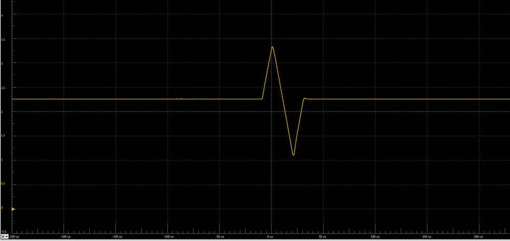

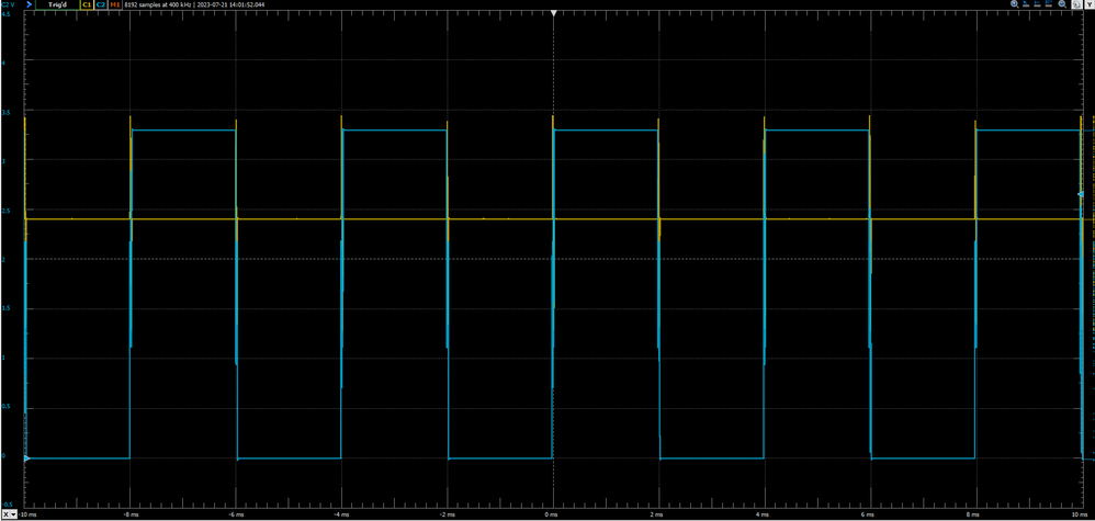

I'm calling the HAL_DAC_Start_DMA function each time the external trigger rises, but, even if the trigger is repeated each 1ms, the signal is generated each 2ms. The minimum interval between a signal generation and another one is 2ms and basically I need to reduce it as much as possible.
Signal
Here the trigger is faster than 2ms but the signal is generated each 2ms

"The DMA is set to normal mode (because I want to generate a signal only when the trigger comes, and not continuously)"
I see misunderstanding how dma works. DMA is not a master, but submissive in this configuration. TIM -> DAC - DMA.
So, dma is waiting request from the dac, and setting "circular" mode is the right way to do . Than you start all process only ones, speed limits I tested with G-474re about ~14 msps with 170MHz clock

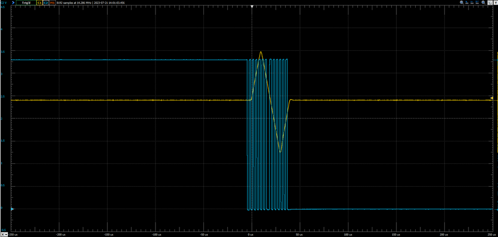

I tried to continuously call HAL_DAC_Start_DMA in the while loop followed by a HAL_GPIO_TogglePin and the result is:
