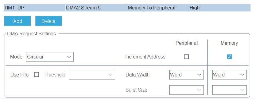

I use DMA burst, Setting is:

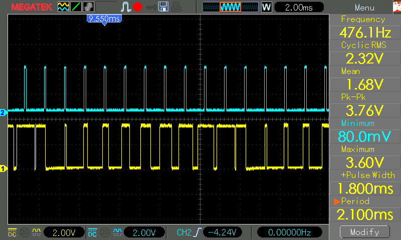

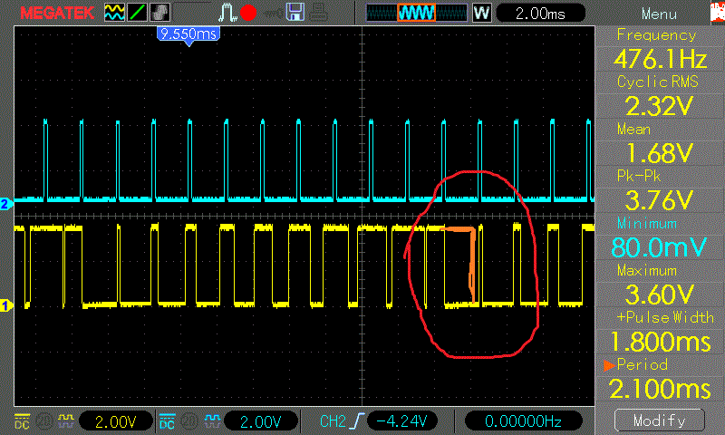

every thing is OK, except last duty cycle, the output wave form is:
it must be like this:
What is the problem? Why the last Section is not correct?

Take that waveform and draw into it the "triangle" representing TIMx_CNT going down and up. Then mark, where does the repetition counter count to 0 - that's the point where te CCRx registers reload. IMO that happens when CNT=0, i.e. in the middle of the pulse. That's why you see the last longest pulse cut to half.
There's probably no simple remedy for this, the center-aligned mode is simply tricky.Maybe the simplest way is to set RCR=0 and account for the fact that update happens boh at overflow and underflow by doubling every value in the table in RAM.
