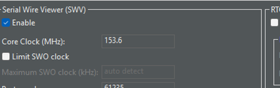

I am dealing with difference between real measured frequency and set on my Nucleo H755ZI-Q.
the measured real frequency :
APB1 76,8 MHz
APB2 76,8 MHz
recalculated
debugging frequencz SWV Core Clock 153,6 MHz
I also try printf debuged frequency:
HSE is enabled and ready.
System Clock: 480000000 Hz
APB1 Timer Clock: 120000000 Hz
APB2 Timer Clock: 120000000 Hz
APB1 Prescaler: 4
APB2 Prescaler: 4

Hello @Sarra.S ,
thank you for the reply, I think that it is not measurement method - also have to set the timers regarding to the value ato be able run the servos. The real frequency is real.
I also have to add the 153.6 MHz into the SWV settings to get the printf values.

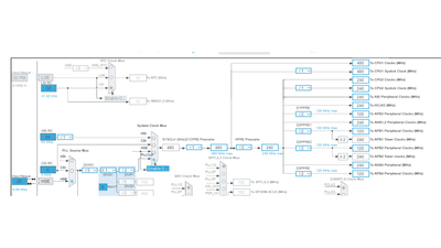

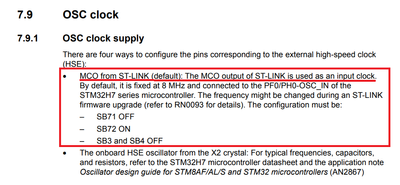

I goes through the user manual once again and realize that the inputed HSE frequency is provided by ST LINK MCO - 8 Mhz. There was set authomaticly 25 Mhz in the clock configuration.
https://www.st.com/resource/en/user_manual/um2408-stm32h7-nucleo144-boards-mb1363-stmicroelectronics.pdf
7.9.1
I followed tutorial paths for set HSE, but nobody mentioned, that it is necessary to improve the solder bridges on the board to connect the external oscillator. This is my first STM32 board, so I do not know if it is standard or something special for my H7 version.

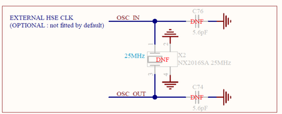

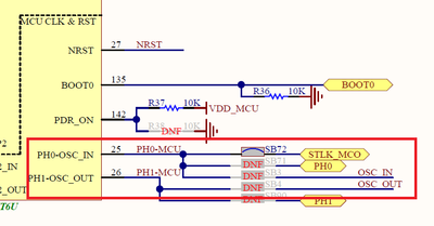

Indeed by default the HSE clock source is generated by the STLINK MCO:
From the board schematics, SB72 is soldered by default:
And the HSE crystal is not available (DNF: Do Not Fit):

Nucleo working as it is, AFAIK ST-Link always provides clock on any nucleo boards, with option 8 or 8.33 MHz.
No hardware re-config required. Simply enter 8 MHz into box instead of 25. Likely software StmCubeMX bug or you start project in another way - from uCPU selector instead of board selector.
