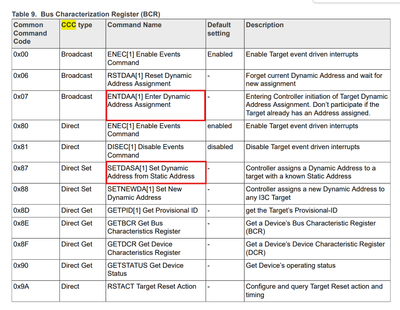

Hello @zakir_daniarov ,
First of all, you can use ENTDAA CCC to assign a dynamic address for  P3T1755 temperature sensor , also you can assign a dynamic address using SETDASA. As showing in this Table of DS :
For SETDASA, make sur that you are using the correct static address for P3T1755.( can just start an I2C communication to make sure that this value is an I2C static address )
Thank you!
