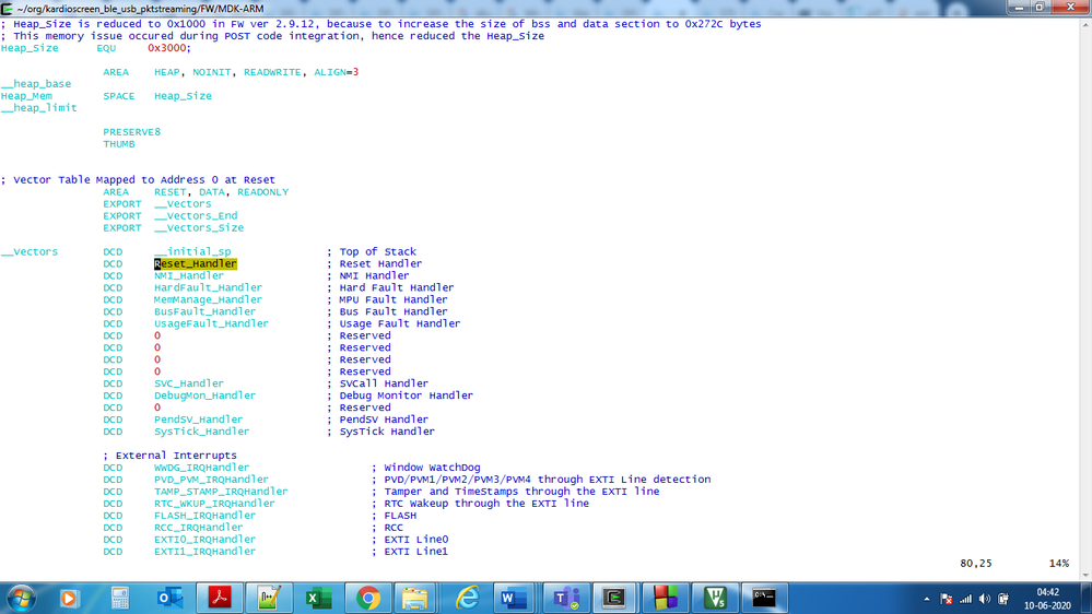

2020-06-09 4:15 PM
Hi clive 1
how to add _estack in vector table startup_stm32l476xx.s
i am using keil ide. i'm not aware of startup files and linker files. please can you help me out
Thanks,
Raghu.
2020-06-09 4:35 PM
__Vectors DCD 0x20002000 ; Top of Stack
DCD Reset_Handler ; Reset Handler
DCD NMI_Handler ; NMI Handler
Reset_Handler PROC
EXPORT Reset_Handler [WEAK]
IMPORT SystemInit
IMPORT __main
LDR SP, =__initial_sp
LDR R0, =SystemInit
BLX R0
LDR R0, =__main
BX R0
ENDP
2020-06-09 10:38 PM
Hi Clive,
Thanks for quick response. now it's working
Thanks,
Raghu.
