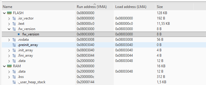

I am just curious about information in the flash.
#ifndef DEVICE_VERSIONING_INFORMATION_H
#define DEVICE_VERSIONING_INFORMATION_H
typedef struct {
uint32_t magic; // 0x46575652 = 'FWVR'
uint8_t major;
uint8_t minor;
uint8_t patch;
uint8_t build;
} fw_version_t;
__attribute__((used, section(".fw_version")))
const fw_version_t fw_version = {
.magic = 0x46575652,
.major = 1,
.minor = 3,
.patch = 2,
.build = 7,
#endif // DEVICE_VERSIONING_INFORMATION_H
I wrote in the linked script file (.ld) some versioning information. I guess it is the best way to store the device versioning information because that way allows the swd to get directly from the flash the version, although, I can get it too by request and response by uart.
However, why there is more data after the version information in the flash memory?
Is this normal? Should the user defined constants in the flash be followed by other information?

2026-01-12 3:16 AM - edited 2026-01-12 3:18 AM
@Andrew Neil wrote:Please show your linker script - hard to comment on it without seeing it!
Ah, now you've edited the original post to add it!
You've only specified the location of your version information; you haven't said that it has to be the last thing in flash.
The Linker has seen that there is space available beyond your .fw_version section, so it has just used it as normal.

2026-01-12 3:08 AM
@carleslsregner wrote:I guess it is the best way to store the device versioning information because that way allows the swd to get directly from the flash
It's certainly a common way to do it.
@carleslsregner wrote:I wrote in the linker script file (.ld)
@carleslsregner wrote:why there is more data after the version information in the flash memory?
Why wouldn't there be?
What you've shown is all standard C stuff: .preinit_array, .init_array, etc are all part of the GCC startup process for initialising variables...
