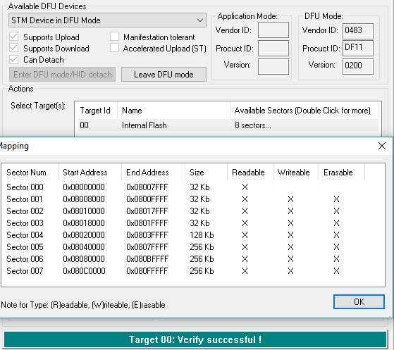

So I'm DFU'ing. Successfully bootloading the device with the USB connections on PA11 and PA12 DFU is built into the STM32L476. Plodding along and loading my micro a few times with a few different compilations all good. THEN ---- POOF. One of them won't verify using DFU.

clive1's routine cleverly uncovered that I had stepped in a familiar hole that has been circulated here in the forums before so beware of your Linker SCRIPTS ( *.LD file - mine being STM32L476ZG_FLASH.ld ) setting your stack pointer to a non 4 (or 8) byte boundary. Mine was set to
_estack = 0x20017FFF; /* end of RAM */ <--------- That caused clives routine to complain about the stack pointer setting being invalid for my STM32L476 (M4 part)
_estack = 0x20018000; /* end of RAM */ <--------- That FIXED it
AND ----- The DFU DEMO loader VERIFY function is HAPPY now also. ---- MAKE NO MISTAKE HERE - THAT was just LUCK.
Apparently I was 1 byte short in the binary which caused the DFU to not verify. By bumping the stack by 1, it
1. Made both the starting point of the stack aligned (made clives routine happy )
2. Made the DFU verify correctly (the newly generated hex / binary landed on alignment boundary)
I confirmed this by using a compilation that the DFU loaded AND verified okay, which also used the estack set to the offending 0x0x20017FFF

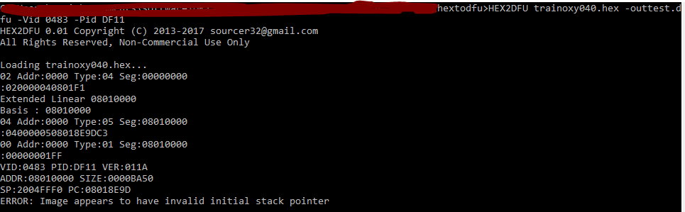

I then checked this with clive1's utility and it reported the 'ERROR: Image appears to have invalid initial stack pointer' message.

we are having the same issue with not matching addresses in DfuSe. We are using the STM32F746VG on a custom board. With the HEX2DFU converter we also get the same error with the initial stack pointer:
We tried different configurations for _estack in the .ld file. Below is our current configuration but we also tried 0x20050000 and 0x2004FFFF.
/* Highest address of the user mode stack */
_estack = 0x2004FFF0; /* end of RAM *//* Generate a link error if heap and stack don't fit into RAM */_Min_Heap_Size = 0x200; /* required amount of heap */_Min_Stack_Size = 0x400; /* required amount of stack *//* Specify the memory areas */
MEMORY{RAM (xrw) : ORIGIN = 0x20010000, LENGTH = 320K - 0x10000FLASH (rx) : ORIGIN = 0x8010000, LENGTH = 1024K - 0x10000}Do you have any ideas to get a valid initial stack pointer?

2018-02-05 7:03 AM
Actually it was my utility, might be the SRAM address is too high for the purposes of the sanity check.
Could you try changing the address in the vector table in startup_stm32f7xyz.s?
g_pfnVectors:
.word _estack /* Change to 0x20002000 */ .word Reset_Handler.word NMI_Handler
.word HardFault_Handler .word MemManage_Handler...
The first instruction in Reset_Handler sets it to _estack so just needs a RAM bound address, probably at 128KB or below

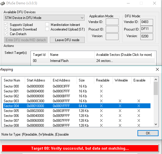

Hi Clive,
thanks for the fast reply. The conversion worked fine but still there is a mismatch in DfuSe as you can see here:
The generated .dfu file is 47Kb so that should not be a problem of size. VECT_TAB_OFFSET was already changed to 0x10000. Also I can download the same .dfu to my discovery board but not to my custom board. The only differences are the package (disco = BGA-220, custom = LQFP-100) and the mapping:
The bootloader on the disco board is the DFU_standalone example of ST's drivers. Any ideas? Maybe we should use another driver version? Currently we are using STM32Cube_FW_F7_V1.8.0.

2018-02-05 9:13 AM
The FLASH banking in the working vs non-working examples is different.
Look at what's going on with the options bytes.
The 3.0.5 version of DfuSe demo predates the F7, perhaps try the all-in-one utility that ST release recently.
