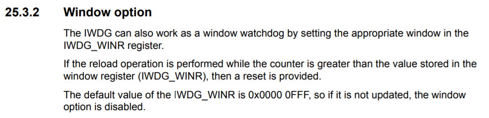

2017-08-30 6:53 AM
Thinking out loud,
Taking a look at the reference manual:
Default window value is 4095, which means disabled.
I'm using this configuration:
hiwdg.Init.Window = 4095;
hiwdg.Init.Reload = 4095;Could this be the problem?
Watchdog clear starts the number at 4095 and if it is cleared again it should cause no problem since the reference manual says greater than and this condition would be equal, but who knows.
