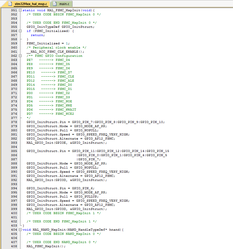

,After check in your project, I found the generation of GPIO initialized in
stm32f4xx_hal_msp.c and called by HAL_FSMC_MspInit () function

Hi Imen,
Interesting. Thanks for checking. Maybe it is because I'm running CubeMX on Arch Linux?
I've tried this .ioc on a Windows machine and the FSMC initialization code is generated.
