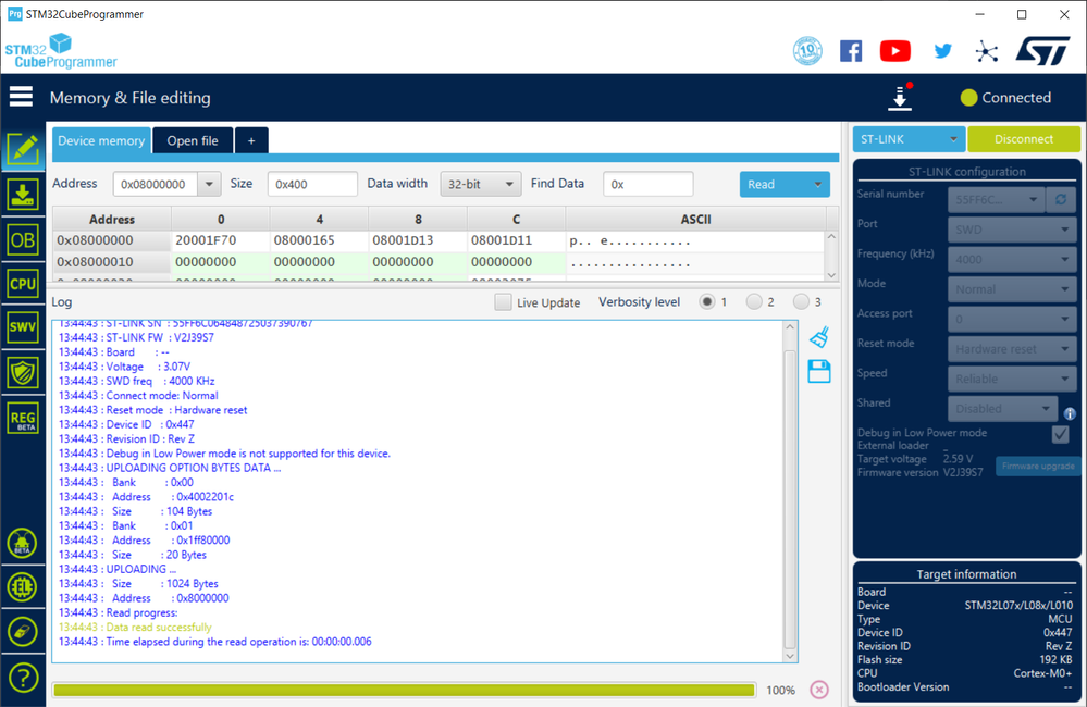

In ST32CubeProgrammer, I can connect to the target MCU without problems:

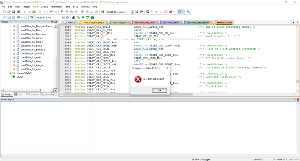

However, when I try to use Keil uVision v5.37.0.0 and click on Start/Stop Debugging Session, I get a dialog box with the message "Trace HW not present":

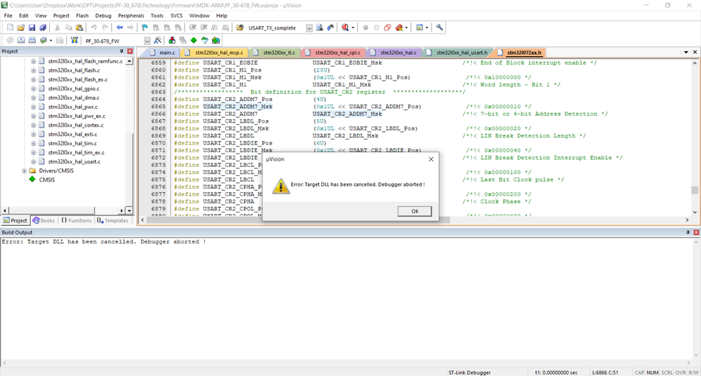

and, when clicking on OK button, another dialog box appears with the message "Error: Target DLL has been cancelled. Debugger aborted!":

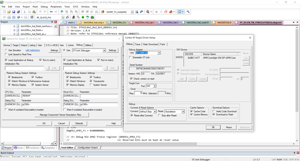

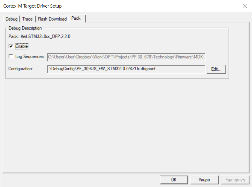

Here are the settings for ST-LINK debugger in Keil:
2023-03-07 4:24 AM

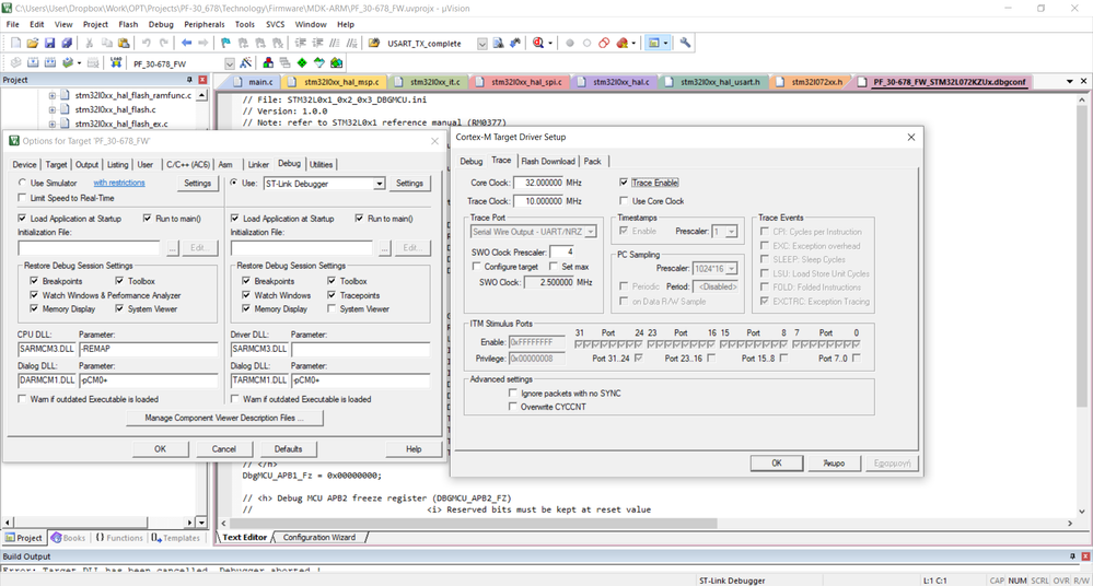

The CM0(+) does not support ITM trace, uncheck the enable box in the trace settings.
2023-03-07 4:24 AM
2023-03-07 4:31 AM
@Community member, that worked for me. Thank you!
