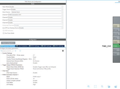

The settings of the timer, when I change the pulse I can see this on the scope. Also when using the DMA function to load the data in it seems that the pulse is dependent on the length of the array, it just seems like it doesnt use the values in the array.
