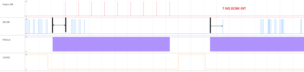

I have the DCMI camera interface on a STM32N6 streaming to the SDCard, and I am noticing that there are cases that the DCMI reports an Overrun when a SD access occurs at the same time that the Hsync interrupt was meant to occur.
Digging into it I believe its due to congestion on the underlying AXI bus, and the IDMA of the SDMMC taking priority over the DCMI DMA. I have set the DCMI and its DMA to the highest possible priority as below.

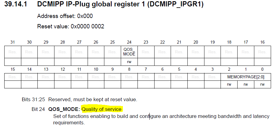

I see that the DCMIPP also has a QoS for the AXI bus. Does this mean it would be given priority at a bus level if a SD transaction was already underway?
However the manual (RM0486 Rev 3) is vague on how this QoS is used, besides:
