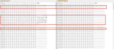

Therefore, I tried to write and read some parameters in this area. I can see the datas is written successfully in "BKPSRAM_BASE_S" section while debugging but when I restart the debug session, BKPSRAM section is all fill with zeros. I know that I am missing something but did not find it.

I also found something else but I do not know what is going on inside of mcu. If I do not use MPU init and write datas inside of BKPSRAM, some of the values are get lost.
I fixed this issue with using MPU. I opened the MPU initialization and added BKPSRAM area section.

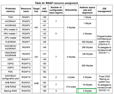

First off, Backup RAM is 8 KB, but RISAF area for that is 4 KB:
When defining full 8 KB Backup RAM area in CubeMX MMT and let it automatically do RISAF configuration and generate SystemIsolation_Config, then that will fail in assert because RISAF23_LIMIT_ADDRESS_SPACE_SIZE is 4KB (minus 1) not 8 KB (minus 1). Assert is valid based on RM table 24, but tool creates bad code.
Okay, so I used first 4 KB.
