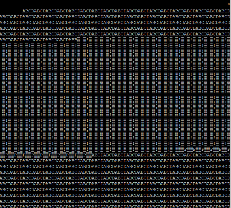

However, the problem is that I receive the correct data only during a certain amount of time and the data is alterd after some itteration. Here is some output of the data on my PuTTy console.
Data captured from PuTTy

Thank you for your response
I changed the code with the following one, but I still got the same problem
