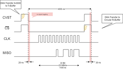

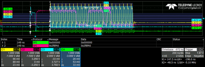

I need to implement a protocol for an external ADC. An SPI read with 22 bits should be triggered via a timer in a 4us cycle.
My procedure:
The protocol on hardware side is working fine:
My problem now is, that the DMA half complete or complete callback is never called (I used HAL_SPI_RxHalfCpltCallback and HAL_SPI_RxCpltCallback and overwrote them in the main). I have already read through some forum posts, the SPI seems to be a real pain. At least the write is now working via a DMA request from the timer, can anyone help me to get the read working?
