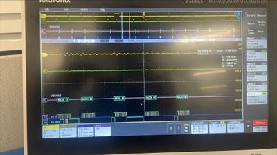

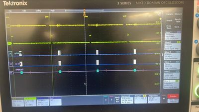

Hi, I've been trying to receive 5 bytes of data from a master MCU using SPI in slave mode.
I have a timeslot control signal, and on each falling edge of that signal, I need to receive 5 bytes from the master.
The timeslot control signal consists of one long pulse followed by 15 short pulses.
Exemple: i receive the data for timeslot 0 at the end of timeslot 15 and so on.
I want to start receiving data from the second cycle of the timeslot control signal, and stop at the end of that cycle,
so I can compare the received data with what I’m supposed to get.
the yellow signal is my timeslot control and the green is the duration of the HAL_TIM_PWM_PulseFinishedCallback
here is my code:

I put tim7 for the dma timeout (3 microseconds).
My problem is that:
when i put a breakpoint on read_data_finished = 1; and i have a free run PWM
the output is :

Add new expression how can i have is_timeslots_readed[15]=0 (that mean dma not finished) and
If i reset and i jumb again on that breakpoint i will probably have something different and when i put uint16_t NumberOfTS_Cycles_to_Run = 2, i have the same problem?
Is there something that did not do correctly?
