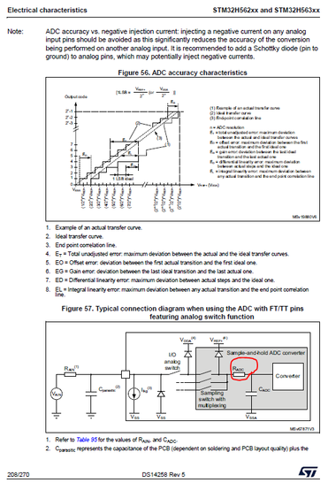

Please let me know STM32H563's RADC value.
There wasn't RADC value on datasheet of STM32H563.

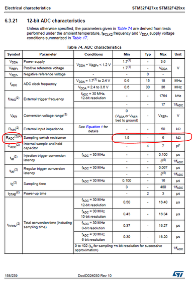

STM32F427's datasheet have RADC value.

Dear @tomy ,
We do not provide Radc in Datasheet , but instead we define the Rain values for each minimum sample rate and resolution. Can you let us know why it is not enough for your application use case ? Thank you .

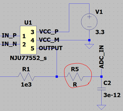

I'm considering about OP-AMP circuit before ADC.
OP-AMP do not have output impedance active specification.
I want to know RADC of STM32H563 for simulation.
R5:RADC
