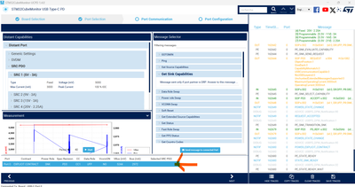

Hi @FBL ,
The explicit contract has been completed correctly, but it is unable to select a source PDO (the Selected SRC PDO is empty, as shown in the image by the arrow).
PFA, trace, and screenshot.
I appreciate any help you can provide.
