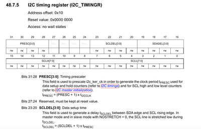

I would like instructions on how to get the timing above: 0x60808CD3
I have reviewed the Reference manual, but haven't had any luck with how it get's the values for SCLL, SCLH, SDADEL, and SCLDEL. Or the best rule of thumb with choosing the values.

2025-04-03 10:47 AM
i would recommend using Cube...its just for making life more easy.
But if want to go the hard way... take the rm and read...
1. the I2C module gets a clock...see in your clock tree, what you give to it.
2. it has an prescaler...set it.
3. then set the sck hi and lo times, to get the clock speed you want:
Take a scope and look, sending something on this I2C, what comes out...and adjust, as you like it to be.
> Another question: SDADEL and SCLDEL does it calculate value every single time so on a different board (but with the same board) it might have a different value or would it be the same with the same chip.
i cannot understand...but if same clock tree setting on same chip type, same i2c timing will result, if same timing set.
